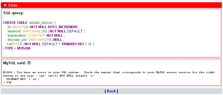

I'm trying to install it in my Forum but I have a problem with the SQL statement when I run it in the phpMyAdmin.
This is the part when I have the problem. :cry:
CREATE TABLE `phpbb_lexicon` (
  `id` bigint(8) NOT NULL auto_increment,
  `keyword` varchar(250) NOT NULL default '',
  `explanation` longtext NOT NULL,
  `bbcode_uid` varchar(19) NULL,
  'cat' int(8) NOT NULL default '1'
  PRIMARY KEY  (`id`)
) TYPE=MyISAM;
INSERT INTO `phpbb_lexicon` VALUES (1, '1th example', 'This is a testentry to example the character-navigation.<br />By default the numbers does not shown. They only will display if exist a entry.');
INSERT INTO `phpbb_lexicon` VALUES (2, 'Testentry', 'This is another entry to example the lexicon.');
The rest I run without problems. :P
Thanx for your help and sorry for my bad english. :oops:
What I have to do ? :?
I attach the ERROR in my phpMyAdmin.

Beitragvon oxpus » 9. Jun 2005 09:52
Try this:
  'cat' int(8) NOT NULL default '1' ,
  PRIMARY KEY  (`id`)
) TYPE=MyISAM;
There was a commata missing after the definition for the field "cat".

Beitragvon mariocaz » 9. Jun 2005 21:13
Hi AmigaLink !
With this changes...
  'cat' int(8) NOT NULL default '1',
  PRIMARY KEY  (`id`)
) TYPE=MyISAM;
I continue having the same problem (ERROR). :cry:
What's happen?? :( Are u very sure that are ok ? :?

Beitragvon AmigaLink » 9. Jun 2005 22:23
Ok, this must work:
  `bbcode_uid` varchar(10) default NULL,
  `cat` int(8) NOT NULL default '1',
  PRIMARY KEY  (`id`),
  KEY `cat` (`cat`)
) TYPE=MyISAM;
Because it is an export of my Database. ;)

Beitragvon mariocaz » 9. Jun 2005 22:59
Thanx AmigaLink!
That fix that problem. :P
But now the ERROR is in this part: :?
mariocaz
Beiträge: 148
Registriert: 9. Jun 2005 07:35
Beitragvon AmigaLink » 9. Jun 2005 23:16
INSERT INTO `phpbb_lexicon` VALUES (1, '1th example', 'This is a testentry to example the character-navigation.<br />By default the numbers does not shown. They only will display if exist a entry.', NULL, 1);
INSERT INTO `phpbb_lexicon` VALUES (2, 'Testentry', 'This is another entry to example the lexicon.', NULL, 1);
